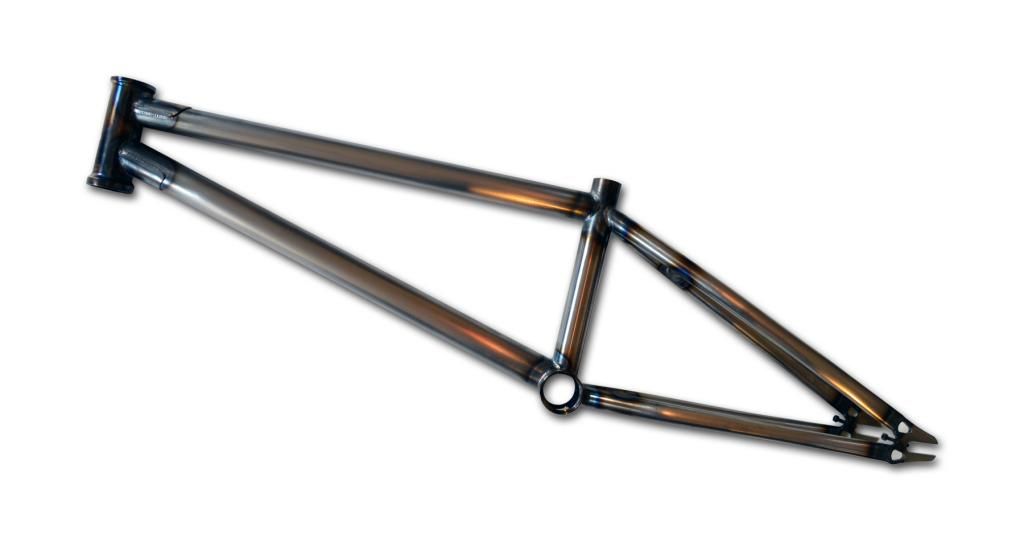

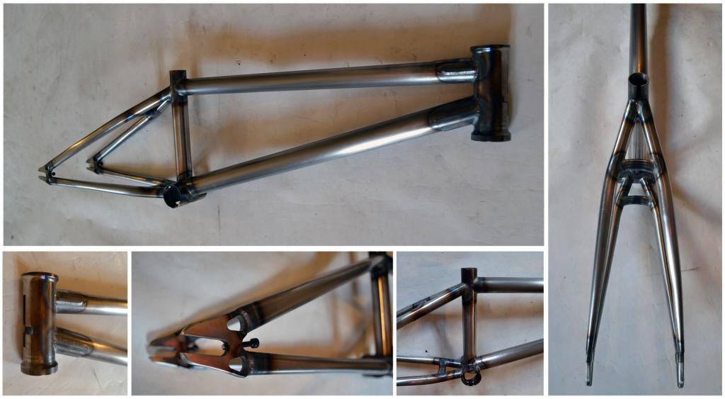

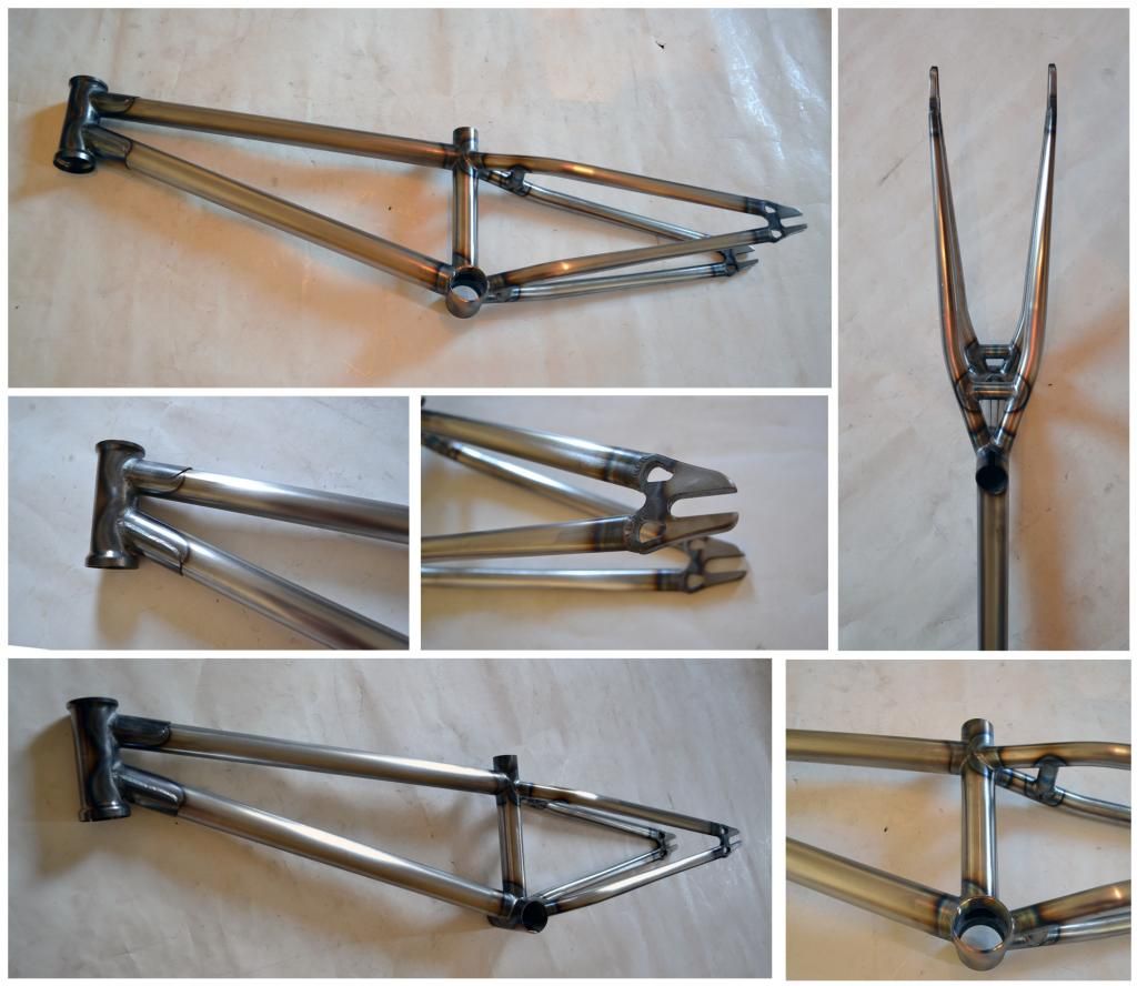

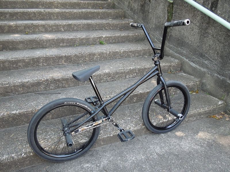

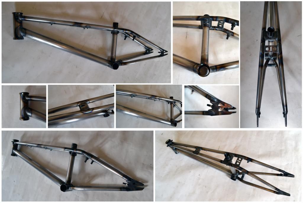

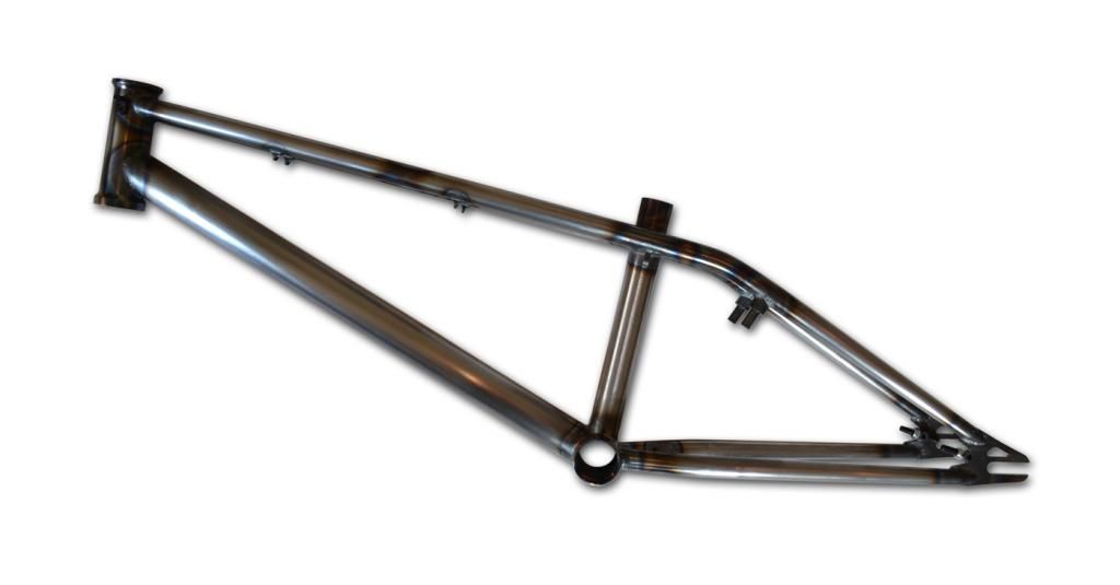

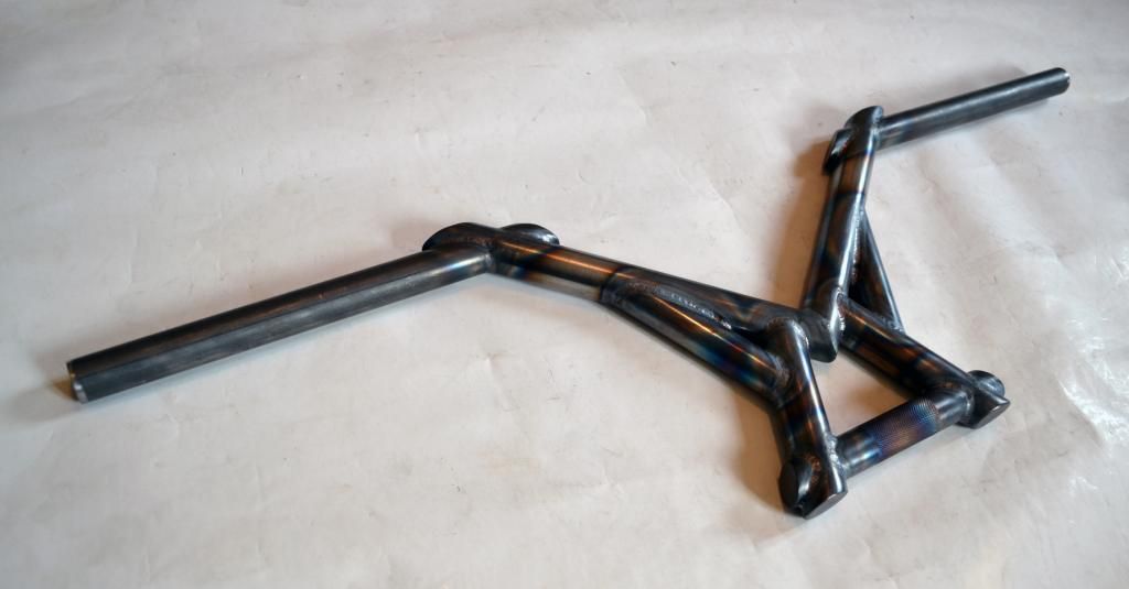

Inspired by the Kuwahara Exibitionist without the double down tube
Twin top tube designed
TT = 19.2"
CS = 13" slamed
HA = 74.5°
SA = 69°
Standover = 7.5"
BB height = 11.5"
114 mm long headtube with removable gyro tabs
4 cabble guide, double cable stop and welded brakemounts
Internal gusset for the down tube
Externally machined seat tube
Spanish BB
Swaged & bullet tipped CS and SS
0.19" thick laser cutted dropouts with 10 mm axle slot
Integrated chain tensionner on both sides
Weight : 1950 g

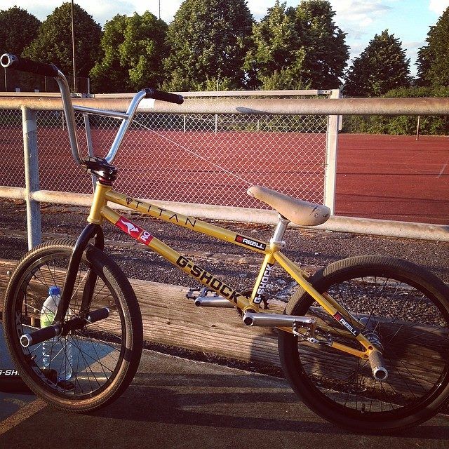

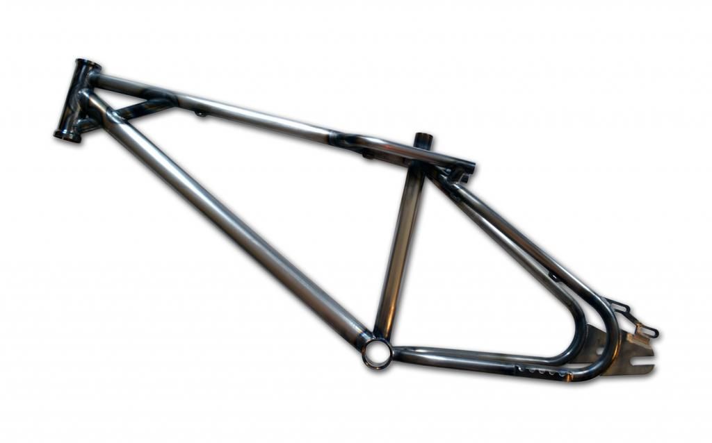

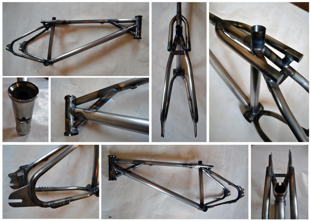

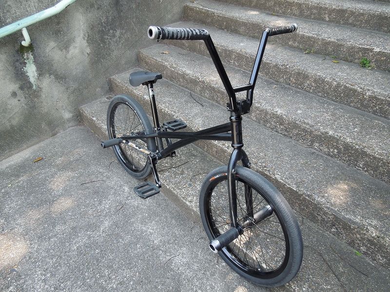

Le vélo du japonais Günter avec son cadre PiR "poutre" 4ème génération :
